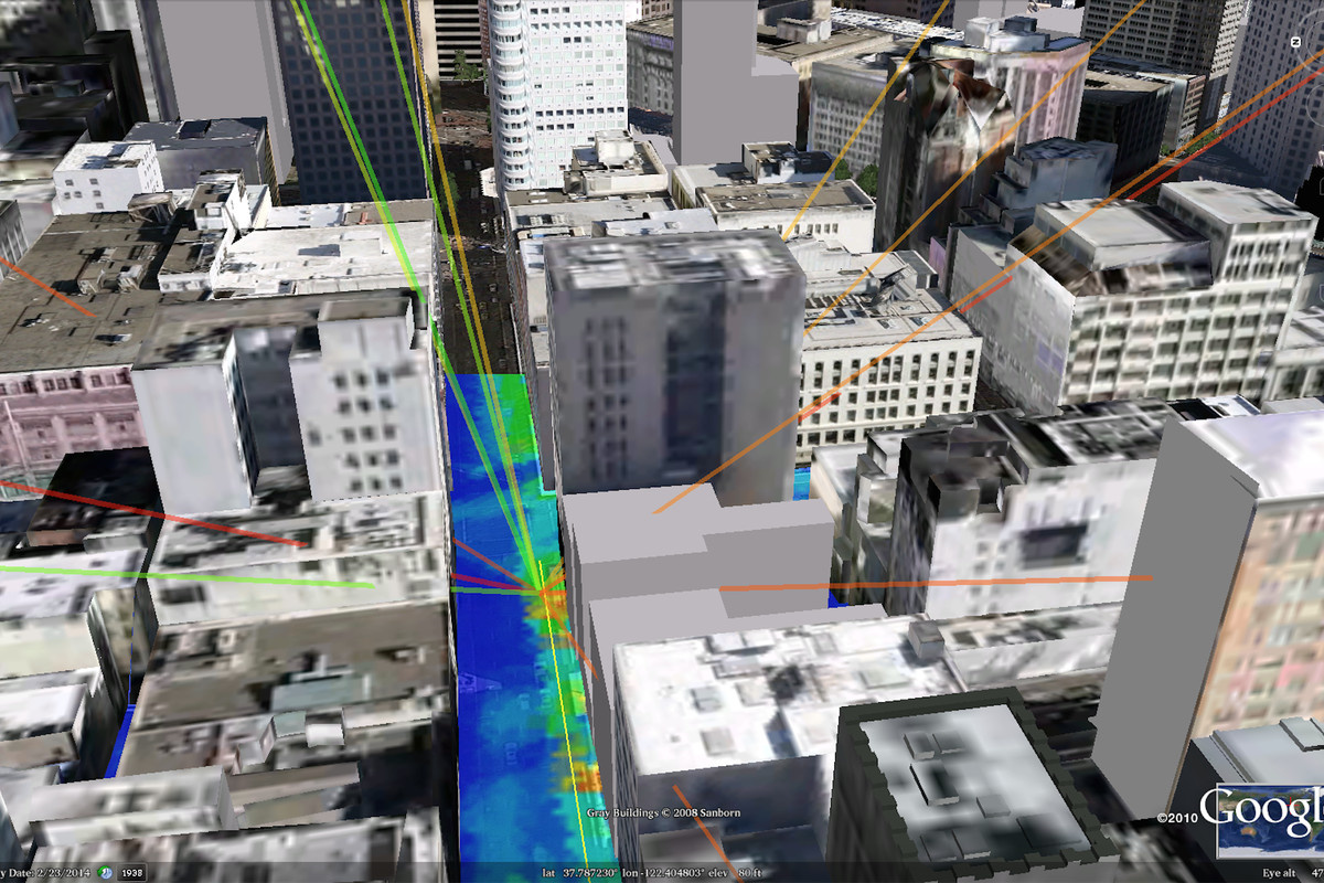

The way around the problem is by integrating occlusion modelling into the GPS system, where the system has access to a 3D model of the city. The new rendering algorithm then makes an estimated :guess" as to where you really are located. Through the collaborative use of over 30 satellites at any given moment above a city, will generate a high probability of accuracy for such a "guess."
Iland explains "Pretend there are only three satellites. So, if I can see satellites C and D with high signal strength, but I can't see satellite B, then I'm probably on the left side of the street where satellite B is blocked by a building. If I can see B and C, but I can't see D, then I'm probably on the right side of the street. And so we're using the satellite visibility information as part of the algorithm, instead of just assuming that all satellites are a line of sight."
Red Blue
ShadowMaps uses the old raw GPS data colored in red and superimposes the new SM data in blue. As Island states, "It's basically like negative information. You can make assumptions based off of what you don't see, in addition to what you do see."
There are issues with their model, and this includes the use of ray tracing, where a satellite signal is color-coded by strength, used to illustrate likely locations and cut through the noise. This produces an issue termed multi-path fading, which is when the satellites signals bounce off of buildings that intersect with each other, strengthening some of the signals that aren't in direct line of sight. This complicates the algorithm and can lead to erroneous conclusions about the location of the driver and rider.
Irish adds "So if you kind of ray trace over a grid and you score these locations over the grid based off of how well they agree with the satellite signal strength and the 3D building models, a lot of these noisy effects that we were describing before average out. You just want to have a better tighter estimate to account for how much faster cars move."
Iland explains that "Each probability calculation takes between 20 and 100 milliseconds, and can run every four seconds for riders and more frequently for drivers."
